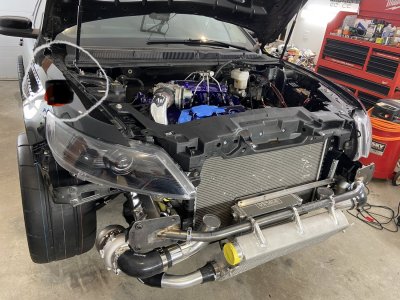

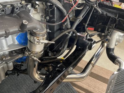

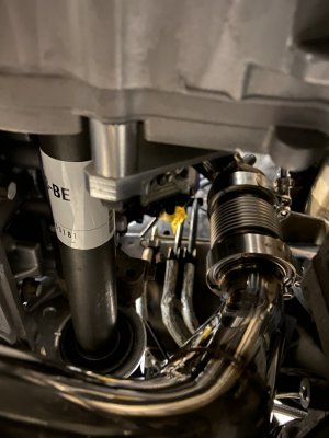

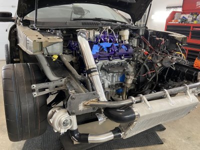

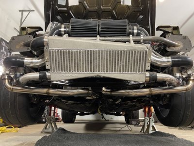

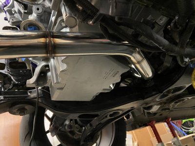

Good work Andrew! Do you think you might have to wrap the exhaust ? It looks very close to where the oil filter will be.
At the very least all the exhaust will get wrapped. I’d like to get them all coated in Jet Hot or a similar coating AND wrapped. I wish I just polish them I love the shiny stainless and tig welds, kind of stinks to cover it all up but…not sure if just a coating would suffice. It’s really no closer than OEM downpipes I think though

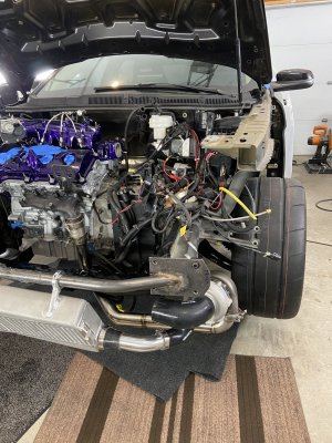

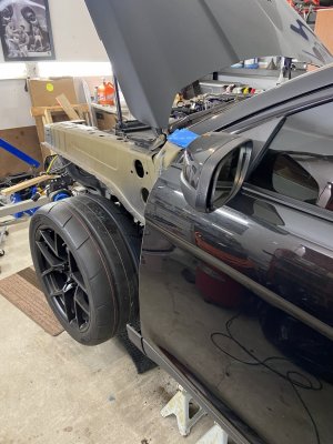

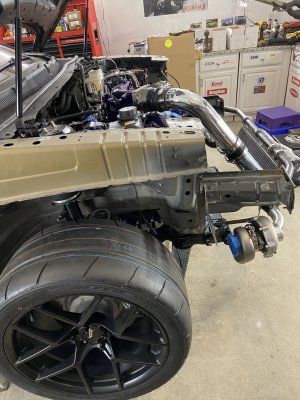

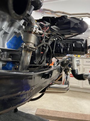

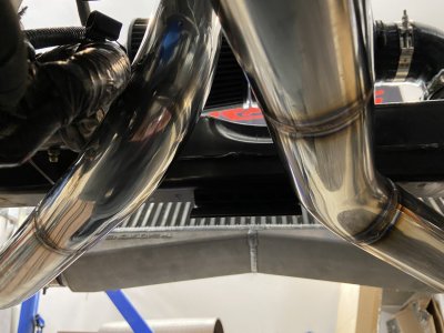

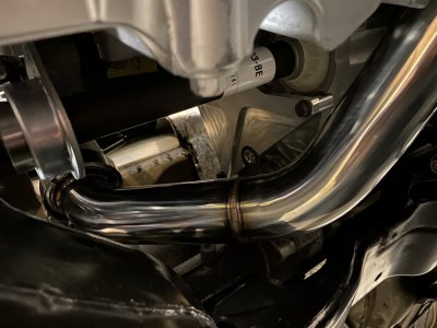

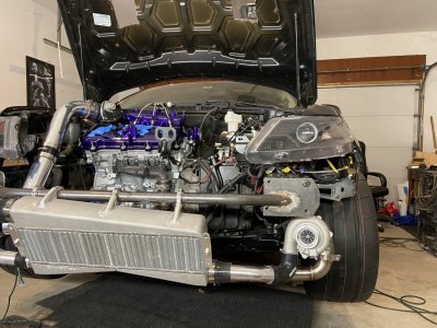

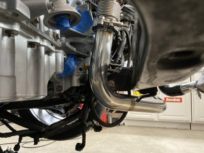

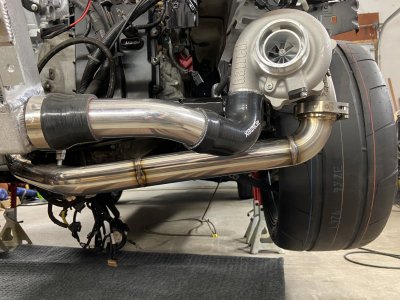

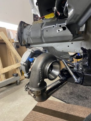

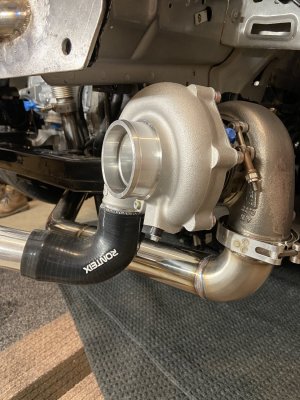

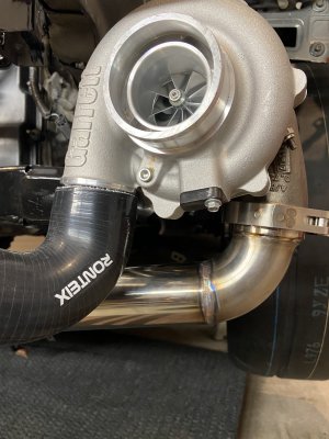

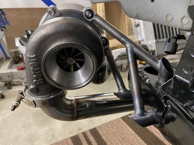

Not much going on this week. A few things were ordered and just came in. 2 J shaped pipes of 1.75”, 2 (1.75” bellows), 2 (2.25”) 45 angle sections, 1.75” silicone purge plugs and 2 Sparco Racing tow straps. One Sparco two strap will get added to the front and rear. Ready to be towed to, from or off the track. Plus it’ll look cool. All about style with some function.

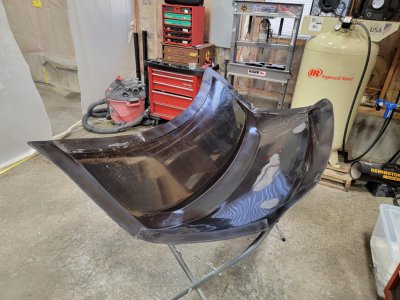

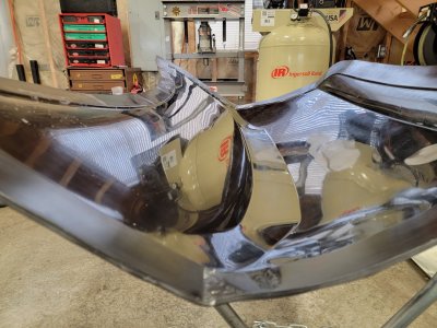

In preparation for the turbine outlet fabrication I removed both front fenders. 41D4EA70 D210 408D 9B1B DE0393930EB1A53DE3B9 6942 4DCC AA5F 682F06566DEDA6752420 2AD1 4155 83C9 A35099946E5EE1383DEF AF97 4741 A95C D7F38AC7355F
Each exhaust will exit from each fender! Going to give this Bull some horns!! Something like thisD067F9B6 8674 4756 8F4E 5CB362C6876B
Ben is coming back Monday. Going to get the rear turbine inlet done then start on the fenders exits I believe. Or the wastegates. And for maximum performance each wastegate will be completely divorced from the turbine outlet. So they’ll have their respective piping out of the fender too.
