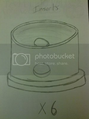

so this is what we cam up with (not perfect i sketched them up in 10 mins) but some thing like this. remember it is just an idea

and thinking to make the inserts +.0005 and the housing -.0005 heat them up and press it in. it is just an idea but let me know

If your caliper is only marked in tenths of an inch perhaps . . . .
1/10000th of an inch is not something a caliper is capable of measuring accurately. I know, I know, most digital calipers display out to four places after the decimal, but a caliper isn't something I'd use to check any tolerance lower than +/- .005.

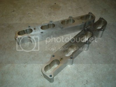

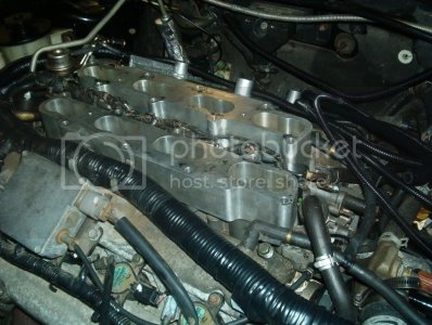

You can go a little bit bigger than the 1.5" spacers. This is what I used to have, but like you said, cutting a hole or losing the entire intake is what is going to need to happen. And fitting the M112 is not impossible, but doing an M90 is feasible with a little mod to the the strut tower area.
