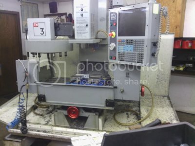

IMG 20120807 131046
tm3

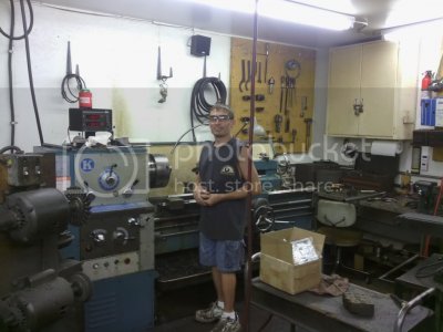

brother on the lathe

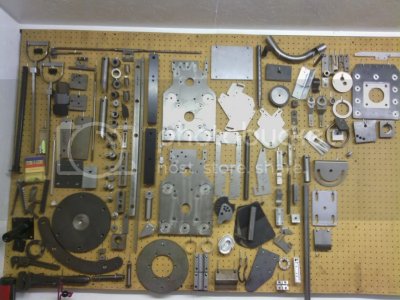

some of the sample parts we have ran

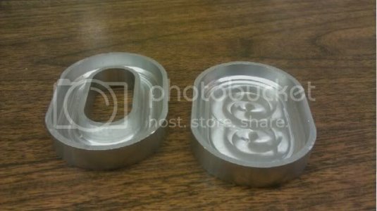

parts with tolerance of +/- 0
Imagejpeg 4
+/- 0 also
so this is just a few things we have made so throttle bodys and bbbs and other sorts are not all that challanging

Also I would be really interested in finding out how to make parts with 0 tolerance especally scince metal contracts and expands with temp. And where you can find bits at the same zero tolerance to make this happen?

the last 2 peices just for the ringed lip take over 10 passes to do in very small increments and the final 3 passes take off less matirial than half of a human hair each time. it is not all jobs that require 0 just those 2 and it took hours and hours to prefect. i dont want to make it sound like i just whiped them up it was alot of work of trial and error. Also im not selling parts yet just getting an idea of what people would want. no transactions in this thred. and it was intended on being mn local but it does not look like that is the case any more.
This.
I've been a machinist/fabricator/mechanical engineer my entire adult life. Everything has a tolerance, because proper engineering designs it that way.
Maybe an extremely tight tolerance, but 0 is unrealistic and damn near impossible.

yes you are correct i called on it i apologize it was +.00155-0 but still at that is super super close cut
