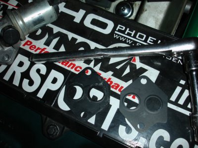

Dropped in another IAB tonight when I got home from work.. warm intake .. mmmm..
anyways.. car works again!!! unfortunately on the way home from work one of the idlers went out, first it sounded like the car was supercharged, then ticking, then grinding, now it's just horrible.. haha.. new one arrives in the morning. :biggrin:
new gasket.. mm
