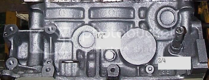

There are ways to do the swap so that it's almost impossible to tell. Common give aways are...
Is the coil pack tilted or level with the ground (this is just a bracket swap)
Does the oil level sensor come out of the front or the rear of the oil pan?
Does the oil pump have an extension going up the left side? (you'll have to look up pictures of the two ... I'll see what I can find and update my post)
Does the webbing on the front of the block look like this:
Cleanblockfront 1
or this:
(looking for good picture)

The webbing on the block would probably be the biggest indicator. If you have the webbing, you have a 3.2L. If the webbing isn't there, you have a 3L block, but who knows what is inside the block.
A swap can be done very discretely by swapping just the block and internals (noted by webbing), or can be completely undetectable (without opening up the motor) by boring out the 3L and swapping 3.2L internals in.
For this information, www.shotimes.com is still a good source for research. I'd like to see that site brought back to life with more up-to-date information and a modern look.
