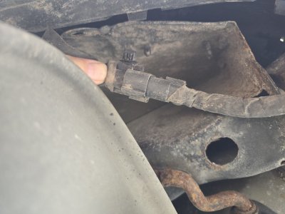

in 22 I had the same issue but the dealer said it was the connection and the bulb housing $345 buck Canadian later. Now this time they say that it has the same green corrosion but further in the harness. Has anyone else dealt with this issue and what is the part number I have to order If I find the right wires leading out from the bumper. I think I see the connection on the driver side and if they checked this and of the dirt that fell on me I find it hard that they disconnected this and seen any issue corrosion or other.

You will have to get the harness part number by VIN. The harness connects to the back up sensors, license light and trunk release. Check the vehicle side connector for corrosion. That pigtail is also available.
