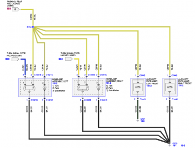

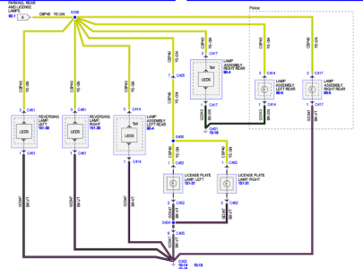

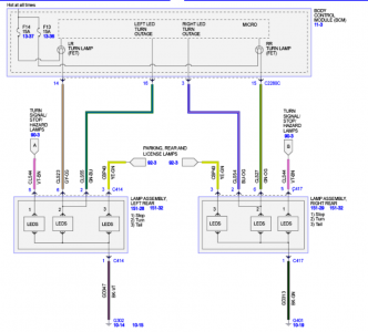

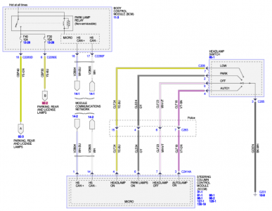

I bought a 2015 SHO about 2 months ago, haven’t had any issues or anything yet. Just noticed my tail lights aren’t working. The break lights and reverse lights are working. I seen some people say that it was fuse 40, I tried that and no luck. Anyone have any ideas? Thank you
Shadow351
Oct 9, 2017
170
115
Hilliard, OH
I've got schematics up to 2013 so hopefully there's not a major change from 13 to 15. Did you verify you have 12V on both sides of fuse 40 in the BCM (under dash not under the hood) or did you just pull the fuse and check it was intact? Do the front parking lights work? Do the license plate lamps work? Tail lights share ground with brake lights and turn signals so looks like you are looking for a + side issue. (Note these are for 2013, hopefully 2015 is the same)1234
