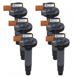

That is still an option. I think I will not try and put the exhaust wrap on after hearing that it will eventually destroy the headers as I live in a relatively wet climate that will hold the moisture close to the pipes all the time. I would really like to keep the Sultans of Spark coils and Pulstar plugs with a tune as I really like those additions over stock performance. I've experienced a noticeable boost in the 'seat of the pants' feel with them (especially at the low to midrange) but I am guessing going with a tune typically requires you use the plugs and coils the tuner recommends, or ones they are familar with? Aside from going with a tune, I wish more people would try these two upgrades and see what they think. I was pleasantly surprised by what they offered.

Unless you dyno the car its hard to tell if those upgrades factually made a difference. Whenever we spend money on an upgrade we are hopeful it works and can be biased towards its success. Whereas with the tune, the seat of the pants, dyno and the track will prove itself.
On other forums changing the coils was of little to no gain if I remember right. And spark plugs was about the same responses. But if they offer any improvement then the tune would really wake it up

Motorcraft coils and plugs are better than whatever you put in there.

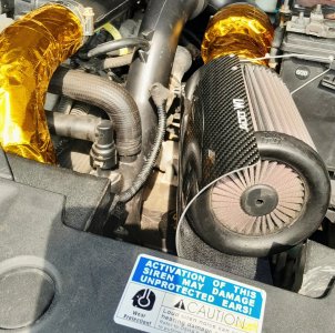

K&N RX-2820 X-Stream, ADD W1 2018 Kia Stinger Carbon Fiber heat shield, DEI Reflect-A-Gold wrapped intake (in progress).

The combined difference of the Pulstar iridium plasma plugs which use an internal capacitor for much more voltage and a bigger spark with more complete combustion) than other plug types with the Sultans of Spark coils (more available spark especially where the engine likes to make its torque at the lower rpms) combines to give a larger dose of more seat-of-the pants power at normal, city driving speeds.
The difference in performance was not subtle over the original Motorcraft parts they replaced with regards to the low end and midrange pick-up specifically. It really is a winning combo with just those two swaps (among other things). It 's now much easier to chirp the tires with traction control on. Granted, with 145k the OEM Motorcraft coils and plugs were getting long in the tooth (probably less on the Motorcraft iridiums which still looked relatively fresh). So the argument can be made I'm just feeling the difference of going to new parts (any new parts?) compared to before.
Interestingly though, everyone said not to replace the original coils mostly because of their excellent durability which I cannot disagree with as they seem to fail the least often judging by the hundreds of posts I've read about this.
I was experiencing no issues other than the car feeling sluggish and slower at lower rpms than it seemed like it should be for a car with as much claimed hp as this should have had stock. I was not experiencing misfires or anything else specifically that indicated the coils may be on their way out.
Anyway, I'm glad I removed the original Motorcraft coils and still have them as back-up and will keep them close by. I was going to try MSD coils, as I believe they will probably help make more power at the higher rpm range than my SOS and Motorcraft coils do, but there appears to be so many failing coil complaints from almost all the major aftermarket performance brands except for OEM Motorcraft and possibly D.U.I. SOS coils among some others (although that could be they're just not as popular and not as many people seem to be familiar with them to give more useful feedback to others) but these coils were made specifically for the 3.5 EcoBoost engine only and it shows with the change in engine characteristics and temperament afterwards. As to longevity, we'll see as Motorcraft sets the bar high.
