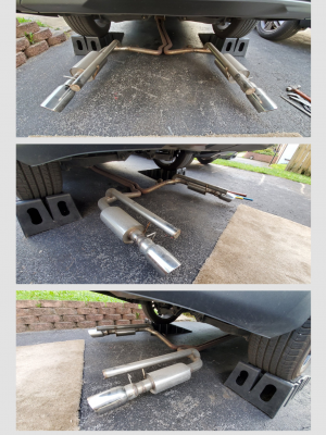

Search here in the forum. I was involved in a exhaust discussion just last week. But long story short, like Michigan-SHO stated, start with YouTube. This is what I chose after listening to his exhaust.
I copied the resonators he had fabricated. 90% of the drone disappeared after resonators installed. Screenshot 20210609 150807 2 I purchased MRT axle back and was going to trash them because the drone was unbearable, now its a rumble from inside the cab while accelerating but quiet at cruising speeds. Best exhaust in my opinion is leave factory exhaust alone, buy some PPE downpipes and get a tune. This picture is from his exhaust, mine looks just like it. Meineke did the resonators for $250.
