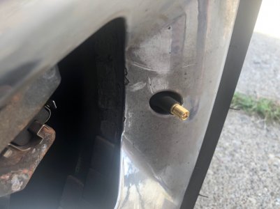

Well according to the Ford website, the build date on my car is 23.02.2010, but looking at the valve stems I see brass. I'll attach a photo.

Those valve stems are normal snap in and do not have sensors attached.
If you look at the link SHOdded attached the cap is much longer.
I do not have experience enough to know if the two are interchamgable, i but I do know there are two frequencies used in the snap in style. I don't know the part number difference or which is interchangeable (attached to the rim vs snap in).
