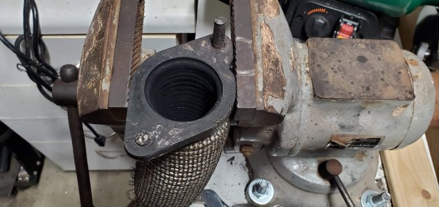

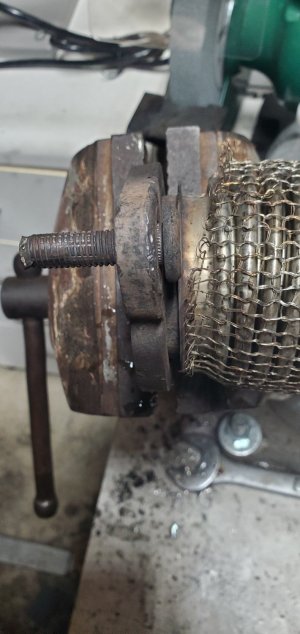

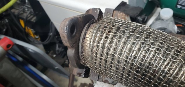

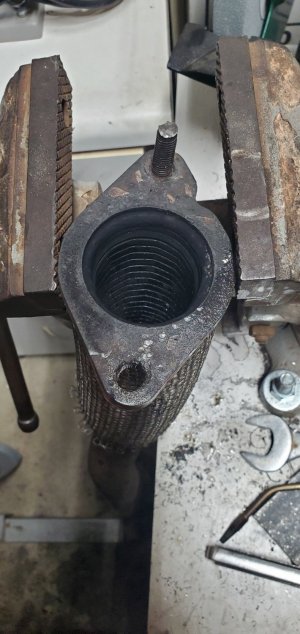

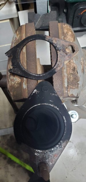

I finally got around to fixing that exhaust leak, and that sound seems to have been solved. The leak was at the donut gasket between the front bank flex pipe and the underbody catalytic converter. The lower bolt broke and the gasket turned into a reed/un-harmonica.
