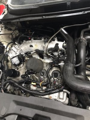

TewSlo
Sep 23, 2021
12
13
Rhode Island
UPDATE: Motor is in, running, driving perfectly. I will talk to my buddy Scott (mechanic) in regards to the specifics pertaining to cam sensor and crank sensor. Other than that the drive home was smooth without issue (didn't get over 40mph, nor into boost.)
