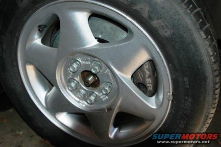

The Baer-ish 12" or 12.5" kits both fit under most 16" rims, although slicers can be a challenge for the 12.5" kits. Even the old 12" kits worked best with spacers for slicers. I run the 12.5" kit under three different types of 16" (non slicer and non TD) wheels with no problems.

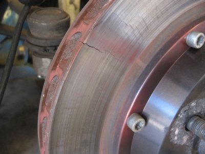

Also, I got a bit more weight savings by going to a 1" rotor rather than 1.1" like Gary is comparing. The 1.1" might last longer, or at least I think it would.
RotorCrack
