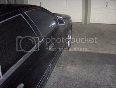

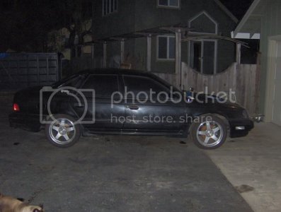

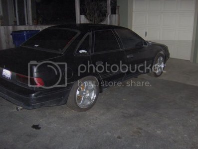

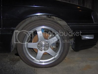

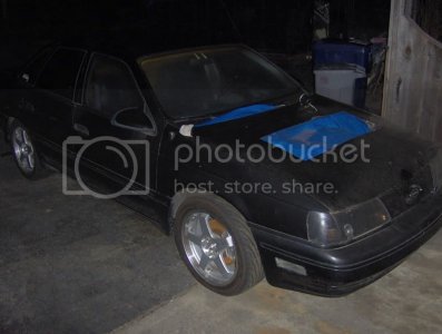

Well, I just finished swapping the knuckles from the '91+ (which is now at the junkyard) onto the Geek SHO, and putting my sweet new rims on. It was a lot of work for just rims, but it was worth it considering they were $300 for the set. I took some pictures, but everything is filthy:
RimsProfile
RimsCU
RimsForeshorten
RimsFrontQuarter
RimsRearQuarter

Those look great. Makes me want to buy the cousins to those kazeras, the asa's that tire rack has. What size tire are you running there? Any clearance issues?
