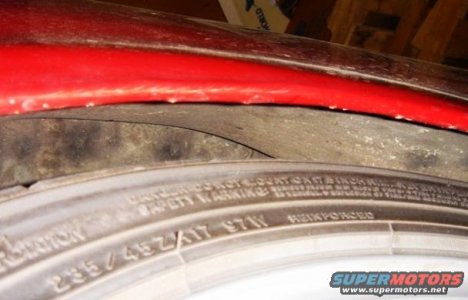

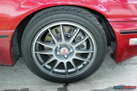

17X8 35mm offset OZ Superleggra with 235/45ZR17. I had to roll the rear fenders and still rubbed a bit in the front and rear when fully compressed. I also have koni/SS Linears. I think the 38mm offset may fit a little better.

The OZ were the lightest 17X8 wheels that I could find at 16lbs each. I believe the TD come close.
