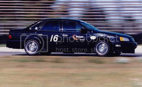

From my point of view, the ROH Snypers were lightweight; about 17 pounds in 16 X 8, they were low pressure cast, heat treated, used pressed-in steel inserts in the lug holes, and were more then adequately load rated for use with sticky road race tires on a heavy sedan. They were a very high quality wheel, one of the few in 16 X 8 that were readily available in the SHO bolt pattern and offset. Can't recall exactly, but I think I gave $175 a wheel for them.
I think they look *******'. I have two sets. :)
Friend of mine had 17 X 8 Snypers on a Gen III SHO and it was a very good looking package.
The Snypers do look much better if they're going fast.
