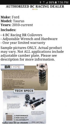

57ce4ae036c8fdcaf75526591d4353b6
Has anyone here tried these?! I found them on eBay last week. I tried on 2 separate occasions to contact them and confirm whether they fit 2013+ PP SHO's but never got a response back. It's not listed on their site for some reason. I'll call them by Friday if they don't get back to me before then.
Sent from my SM-G930T using Tapatalk

if that is the actual top hat they are using i i can guarantee it will not fit. The top hat on mine has the camber adjustments bolts recessed significantly lower then those and they are close. Also Being that megan and bc are the same company o doubt that these will work if the megans aren't available yet.

Those pics are not the actual coilovers (at least that's what it says in the part of the picture that got cropped out).
Thanks for the info on BC and Megan being the same company. I had no idea lol

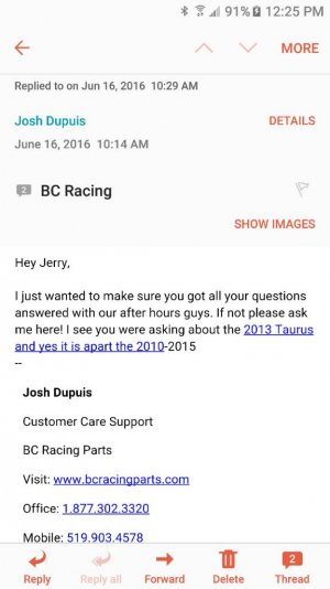

This email reply from my compatibility question was a little difficult to decipher, but I think it means that they do fit the 2013+ SHO
I ended up emailing them, since the reply wasn't clear on whether the coilover's really did fit the 2013+ cars. Here' is the reply:

The kits from 2010-12 and 2013+ would be different simply because they use different mounting arrangements to the knuckle, if nothing else. A kit built for the 2010-12 will not directly fit the 2013+ MYs, at least up front.
And AFAIK Megan and BC Racing are not the same company, though their products may be manufactured by the same company, which has no correlation to equality of quality :)
