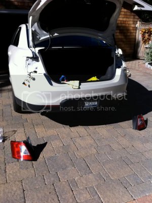

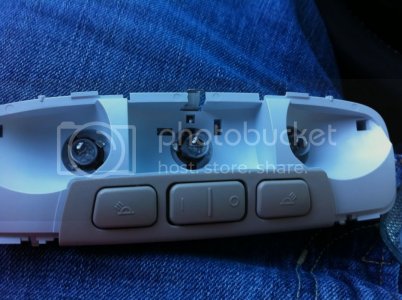

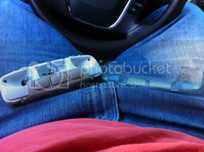

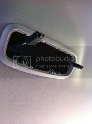

Some pics of mine. I ordered LED tails and turn signals but decided to leave the stocks for now. I am going to order a different type of bulb that throws light in 360 degrees as opposed to the one I ordered that only throws forward facing light.
IMG 1557
IMG 1558
IMG 1559
IMG 1560
I also didn't have the basket thing like you did. My setup was much simpler.
