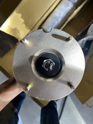

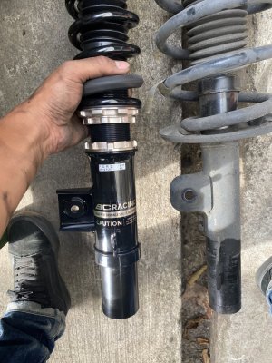

Finally got my BC Coilovers but I’ve ran into a bit of an issue. First issue is I ordered this set thinking it had adjustable camber plates but it came with fixed top hats… Second issue, the box says 09-12 Flex. Now I know the Flex and Taurus share a lot of similar designs, but according to the box the spring rate for the Flex is 6k front 14k rear instead of 6k front 8k rear which it states on their site for the Taurus. Also BC themselves marked the Coilovers incorrectly from left to right… Oh yeah sway bar end links don’t fit as the hole is too small, needs to drilled out to a larger diameter. Lastly, anyone knows which orientation the top hat is supposed to face? I noticed there’s a notch which is supposed to indicate which way to have it orientated but nowhere in the manual or online does it state which way is correct.

Says FL (Front Left) but clearly is the front right according to the sway bar end link mount.
F7A444EB 947F 4BA7 83A4 C4BDC5FCDA59
This is the correct one but this coilover is marked FR (Front Right).

There’s two ways of mounting this and I have no idea which way is correct. Took two measurements from both mounting options and there’s a clear difference in how the coilover is orientated from one or the other. Took measurements from body to coilover body, and there’s about a inch difference.
