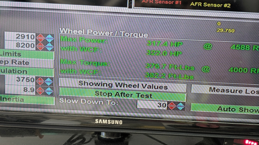

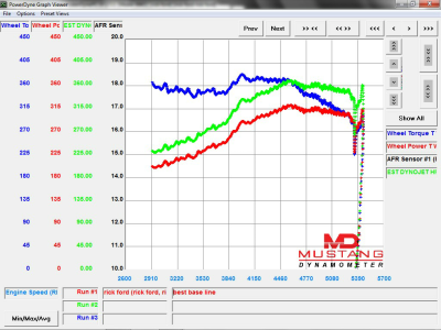

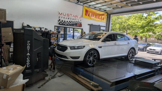

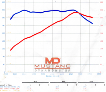

Had a baseline dyno run performed yesterday. Unsure how to interpret results in the graph provided, nor do I believe the numbers shown. My assumption was with a rating of 365HP at the crank wheel output would be quite a bit lower. The dyno was a Mustang brand.
My only concern is comparing before and after, so I am not worrying about it too much. I also had the guy send me a text file with raw numbers. Once I have it imported into Excel and formatted, I will post that.

All I'm saying is that IF the engine is 365 HP net and IF the dyno 308 HP is correct, that works out to approx. 15% loss. Maybe neither is correct. It's all a numbers game.

I finally looked at the text file of one of my dyno runs. The A:F ratio was a consistent 9.5. Is that what others here have seen? Are most stock tunes (amongst all gas vehicles) that conservative?
