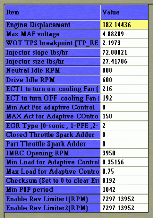

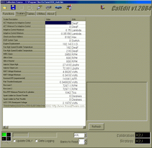

What interesting is that he sent me this fax to prove to me that there was lots of room in the stock injectors. He claimed this was done with stock injectors at the stock fuel pressure, and had more room to move (by the fact that he was able to keep it reasonably rich at high RPM). I remain sceptical, 362 CHP out of 6 - 24 lb/hr Densos requires a BSFC of 0.4 - and I don't think our motors are THAT good.
Maybe our 24's actually flow the 27 lb/hr that is in the EEC scalars, for a slightly more believable BSFC of 0.45, I don't know, I've never flow tested them at 39 psi (or any psi for that matter).
Hmmmm the EEC lists the injector size as being 27 lb/hr? now this is a interesting tidbit of info... makes me want to get my injectors flow tested to see the true numbers.
Yep ..
TwEECer interface (an old version)
Scalars
SCTuner Interface

maxing out at only 200whp?? then again thats was what the g-tech said you had correct? with my figures from personal experiance i have made 542hp on my 5.0 with 24# injectors... cut off 2 slugs and you have a crank hp of 406.5 of course this is with much higher fp than stock but still it shows that theres still more to be had. but i do find this quote of 27.4# for thst stock sho injectors quite interesting does anyone else have some more insight on this?
