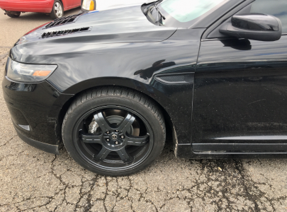

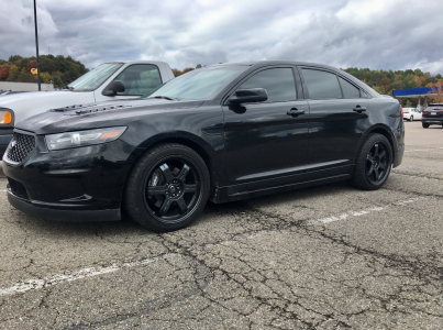

Finally got around to re-installing my wilwood superlight 4 front brake kit and wanted to share a few pictures. Really happy with the improved pedal feel and stopping ability, 25lb weight savings, price point for the whole setup being approx $1,000, and of course the looks!!
I still have Qty 7 adapter bracket kits left in stock if anyone wants a set before they are gone.

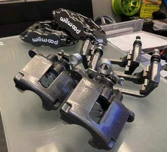

Love the Wilwoods.
Still hoping and wishing Aaron would build a set for the rears! :)
I would love to but there just physically is not space for wilwood's style of caliper and you lose the e-brake function, which is a safety concern. I may dive into it again at some point but I constantly push customers to go with the best bang for their buck setup like what a customer did hear with powder coating the rears to match the front!

For the rear calipers I had them powder coating to match the fronts
