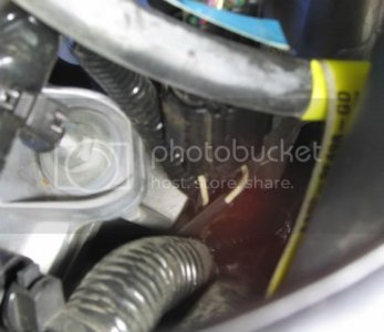

First remove the engine cover just to make sure it's out of the way so you can get a good look from all angles. Look down between the 2 intake pipes.
Go Digging - Big Picture
We saw a connector with wires that were not wrapped in any extra electrical tape or plastic shrouding.

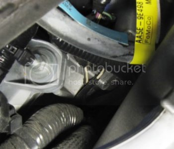

From this angle you can better see the wires resting on the engine.
Chaff - Big Picture
The chaffing is on the sensor side of the connector which means that they will have to replace the knock sensor. In the meantime we have put a piece of foam insulation on the engine where the wires rest to prevent it from further chaffing and giving false knock readings. I must say that performance is starting to come back. Since we didn't reset the KAM memory, it is taking some time for new values/averages that the PCM uses to run the engine are being used and faded out as new values are factored in and averaged. Power is coming back, the erratic RPM's are fading, the wastegate is bleeding off less and less air with every mile I go.
