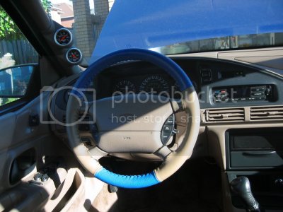

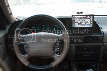

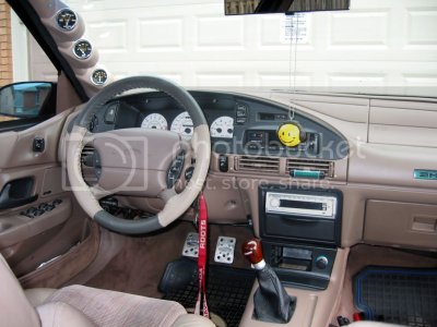

I have installed 4 of them and they're very nice for what they are. Leather is of good quality and is quite thick. Just take your time and wear work gloves to pull the twine tight; I've seen many pics of Wheelskins where people didn't really pull that tight and it just doesn't look right.
Below are pics of the ones I've done, all using the baseball stitching method:
IMG 4535
IMG 5282
The colours might not be the greatest (I know I know, the blue is way over done lol), but they feel great. :p

The colour of your is Oak, and that's the best match to the factory mocha interior. In my green car it was Sand and Charcoal, the Sand is too light but the Charcoal matches the black interior plastic well.
I got the Oak colour for the blue car and as you can see it matches the mocha far better than the Sand.
