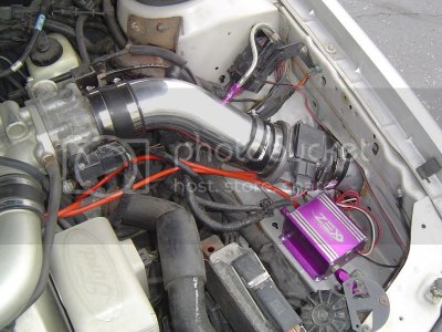

Yeah, got all the wiring/lines hooked up last night. I ended up using small zip ties, they worked well IMO. I also made my own cold air-fender intake, which I'm pretty proud of.....I'll have to post pics. I didn't want to mound the nozzle into the rubber flex line. I can't decide where to put the bottle in the trunk. I would like to put it on the left side towards the back, but there's that sunken in area to stow junk that makes it hard to mount it correctly........grrrrrr.

Thanks man. I do want to keep mine out of the way as much as possible though since I use my car for work, and have to carry stuff in the trunk all the time. Here is a pic of the intake I made up, and where I mounted the nozzle. The zex box is not wired in this pic yet though.....CopyofDSC05851

Thanks! Yes it's autozone, well at least the main part you see, and the rubber connectors. I had a 90 degree elbow from another intake project laying around that I used for the in-fender filter setup. I think the setup cost me $60.
