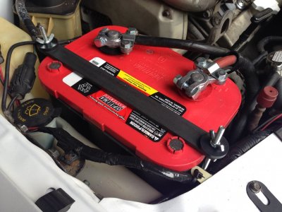

Looking for the positive terminal...mine has a crack in it. '94 ATX.

That aside, I do need the whole cable now. I'd like to replace my positive and negative cables. I'm not really interested in cutting the ends off and putting a new battery post that's screwed on.

I would really get a new one from the parts store. Any 20yr old cable will have corrosion inside the cable. They are cheap enough.

Parts stores sell cable in bulk by the foot. They have it in multiple gauges. Usually keep it behind the counter. Just need to ask for it. Add your own terminals to it as needed.

Mine came from Oreillys. Those are the original cables. Just cut off the old clamps and added the new ones.
