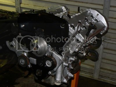

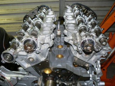

Whew, they are in a few places.... in the middle of a photobucket account with 1500 pics.. here is the motor build..
Motor4
P1000503
P1000514

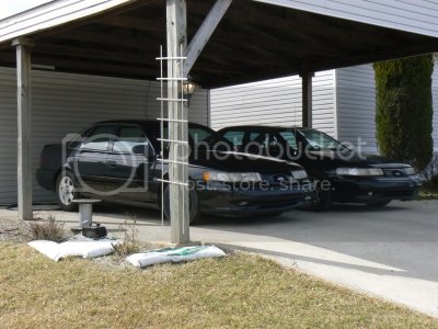

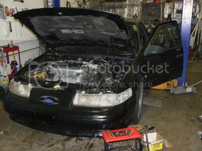

Drove that around for about a year, and instead of tackling the rust problem... I found another body to use from a seized up SHO out of California..
P1060612

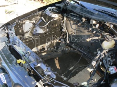

Cleaned it up after I gutted the old motor trans, cut a hole for my 5 speed, yadda yadda...
P1070090
Stuffed it all back in...
P1070184

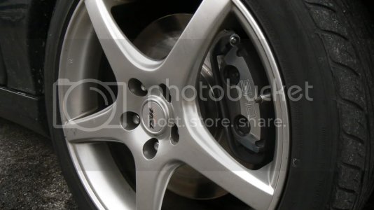

Fixed a braking problem after I added some heavier wheels and tires..
P1080941

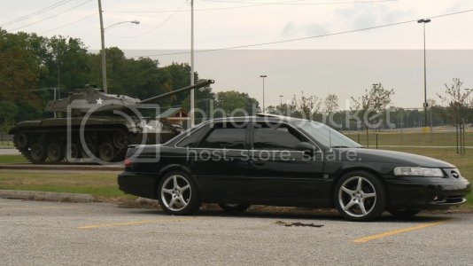

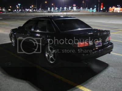

And this is what I'm left with. 30 MPG on the highway, paid off, motor just now breaking in good, and I know I should be fine for another 10 years until the rubber starts to rot again. :)
P1080863
P1080657

Very nice!! More details on the engine build? I like the stance of the car, tinted windows, wheels, and SHO brakes. Very clean engine bay. A lot of hard work paid off!

Well.. engine itself was a NOS short block I cleaned up, put new brass freeze plugs in, and checked for any sort of issues. Sent my heads of the 180k mile engine to a machine shop, had a 3 angle valve grind done, replaces the valve guides, and stem seals, got everything re shimed to spec, and tossed those on. Engine has every bolt on short of cams including a 4 pulley udp set I aquired over the years. But other than that, I just did a lot of simple things like replacing all the rubber vac lines, and little hose clamps, sourced some stainless steel cap screws for a lot of the intake stuff. Found other suspension goodies, and the brake setup from the wonderful people here on the forum.
And.... actually I think the first reply was somewhat accurate, because I did have a lot of help from here and from people I would call pro's around a SHO. Couldn't have done it without the forum, thats for sure.
