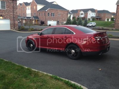

it was a pain in the ass to get everything but i think it looks pretty good for just steelies lol. for anyone that is looking to do this swap you need a few more items then you would think
wheels
tires
hub caps
tps
lug nuts
i wasn't expecting to need lug nuts but in order to be able to fit the little hub caps you need different ones then the ones that come with the sho.
i also found out its not a simple swap every season, every time you swap rims the tps system needs to be relearned, not a huge deal but its an added step.
glad i went thru with it tho, much easier then swapping tires every season.

If this is your first time with the "new" TPMS sensors then yes they need to be learned. I don't have to relearn mine every swap as it remembers all 8 sensors (winter and summer tires).

I've done the same thing and have a complete set of summer only wheels/tires and winter only wheels/tires. Only takes about an hour per year to swap them out once you have everything purchased. I also bought a tire rack that I mounted on the garage wall to keep the off season set off the floor. I bought my rims from Discount Tire and they are the Drag Wheels DR-37 matte black with Michelin Aplin PA3 high performance winter tire. Never an issue and goes through the snow with ease. Welcome and I do like those steelies on the red car. Looks like it could be a fire chiefs car.

thanks, they were more then i should have had to pay but they are actually pretty hard to get... it all depends what you want the rims from tire rack are a lot less, but i wanted this look

good to hear, firestone was saying they need to be re learned every time but that is good news, thanks.

I got to say that I was expecting your car to look like a police car but turns out that I really like the looks. I keep going back to look at your pics and they look badass.

just did that to my car a few moments ago, mine looks like a cop car though, i have the tuxedo black color, oh well its just for the winter which my baby will never see the snow or any salt anyways :)
looks good with the red though

wheels
DG1Z-1015-A
hub cap
F87Z-1130-GB
ill have to find the invoice for the tps sensors since it was on a different one then the wheels.

these cars sure look good with steelies. I went a different route, I bought some 18" mustang wheels cheap and then got one heck of a deal on tires so i couldnt pass it up.

Yeah, def looks good with the steel wheels. Really looks like a police cruiser now. People still go slow around my '12, esp at night cause they think its a cop car. even though I have Livernois decals on it.

Great job. I'm trying to do the same thing to my red 2013 SHO.
Long story short, my wheels need repainted. I looked for steel wheels like what you put on your SHO, but didn't find anything I liked. I was thinking of buying a set of the Continental Extreme Contact DWS tires and leaving the factory wheels on through another winter. But now after seeing what you've done I think I will buy both DG1Z1015A F87Z-1130-GB so I can get my factory set re-painted. Can you post a close-up pic of the wheels and tires on your SHO? What are the specs and sizes on the tires that will fit that steel 18 inch wheel?

thanks, i sure can just going to take me a day or two but ill get you one.

Pretty sure....Nope, Positive, I saw your car parked outside my service department last week...
Those tires are beefy, and the car looks great by the way.

i got the same size i believe 235/55/18s with same steel wheel didnt get the caps though didnt feel like forking out another 200 for them. love how they look though. we just had a huge dump of snow and -25C temps and the michelin x ice have been amazing. i went to a thinner tire for the ski effect that happens in deep snow and i got the bigger sidewall for those curbs hidden undersnow in parking lots.
