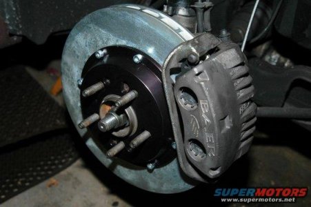

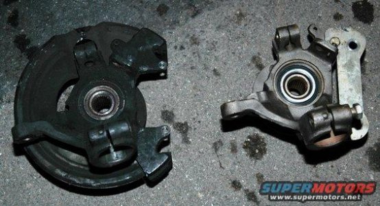

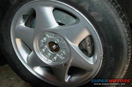

All the wilwood set ups that I have seen used modified hubs and brackets. The cobra set up needs IIRC the 1994 and up hubs. I have hubs modified to take the corvette offset rotors.
1991 stock hub on the right. modified hubs with bracket on the left.
Dsc 0008
Installed:
Dsc 0021

I purchase the Baer Racing set up used. Baer Racing was designed before the Gen2 SHO and came with modified hubs. I had TCE make two piece wilwood curved vane rotors for my Baer Racing setup. It just so happens that the slicer still fit and so I could use them as a spare. I installed 17X8 OZ Racing Superleggera with 235/45ZR-17 tires on my SHO since they were the lightest 17X8 wheel at 16 lbs each. The modified hubs wiegh 6lbs less than stock and the 12.5" rotors wieght one pound more than stock. I was able to reduce unsprung weight and at the same time increase my braking power and cornering power at the same time. Wilwood rotors are easily available and I just unbolt the old from the centers and attach the new. The Baer Racing/PBR calipers are easy to find at stores and junkyards. The only modified parts I have are the hubs and the custom two piece rotors.
I wanted to have the lightest set up, use slicers for a spare, increase braking power, reduce fade and improve handling. I think I achieved my goals. Everyone has different goals and different ways to get it.
