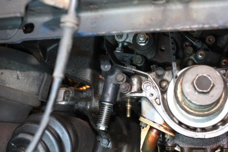

Here is the ATX tensioner installed - this is the best pic I could get:
As you can see, it works quite well. One note about its design, though (Scott, you listening?): The top nut really needs to be secured to the housing, as otherwise it just spins with the bolt when you're trying to adjust it unless you hold it with a wrench or something. With the lower timing belt cover on, however, it becomes impossible to get to that top nut. We used JB-weld to secure the top nut to the housing, and haven't had a problem with it since.
Otherwise, it makes a timing belt install go from about an hour (fighting with that #%*@#$ tensioner with a stupid c-clamp) to about 10 minutes. It was a very simple affair. Also, the bottom bolt is very easily accessible with everything put back together, so tension changes in the future are a simple 1/2" socket or wrench away.
