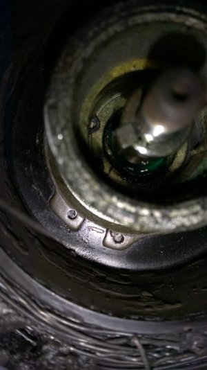

Thanks. Not sure what you mean by "galled it" though. I was able to get the rest of the pulley and bearing off at least now. I was apparently trying to grab the wrong retaining ring. Here is where I'm at now.
EBhUaSEl
I'm assuming that the retaining ring visible in this pic outside the metal cylinder that surrounds the shaft and inside the coil is what I need to get off? I'm not sure how I can get to it. My snap ring pliers won't reach. I tried using hex wrenches in the snap ring tool but because of the way the wrenches are, they sit awkardly at angles and don't really work.

yep. that big ring holds the coil on.
I did once take one off while the compressor was still mounted. it took a couple hours and tons of cursing.
