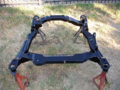

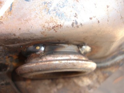

The subframe. I have mine done in the back so as not to get in the way of the bushings, but I've seen them welded in front too.
Good time to do it is when you have your frame out for paint. Or any exhaust shop can usually rip out the strut rods and weld the cups.
Dsc09117
Dsc09123
*edit.. Also if you don't mind going a little stiffer. Moog TPR bushings: MOOG-K8516 (at frame 1 required) and MOOG-K8613 (at LCA 2 required). Or you could try the Prothane 61214 which doesn't come with washers but is probably cheaper than Energy.

Thanks for the reply.
Okay, ...so it's the cup where the strut rod mounts to the sub frame.
