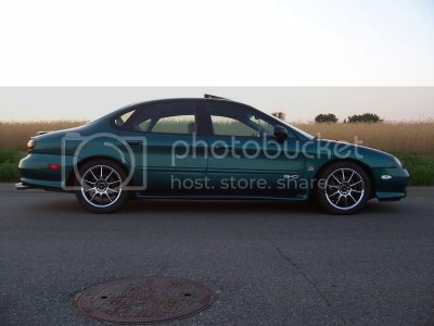

Don't even think about 18s if you're not going to lower it. Even 17s will make the car look like a 4x4.
Here's a pic of my SHO with 17x7 wheels, 215/50/17 tires and lowered for reference:
100 0736 edited

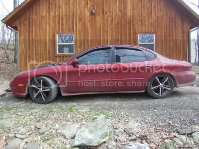

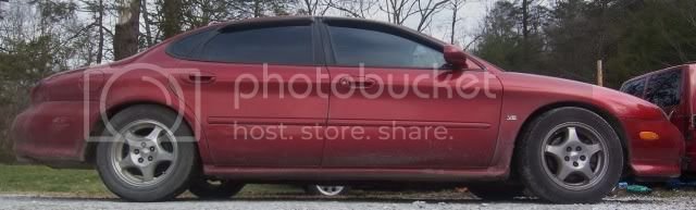

Sidedown
Stock wheels and lowered.
100 2094

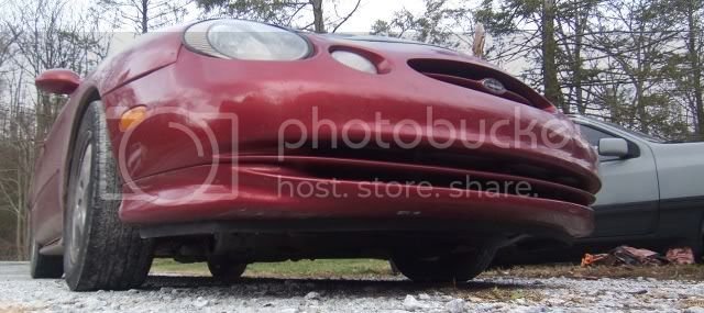

18's and lowered.
Downrightfront
Front ground clearance. It isn't so bad. The parts I used to scrape when at stock ride height are the same parts I scrape lowered. Not really too drastic. If of course you can find Eibachs now.
