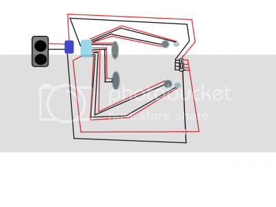

Next question - if i have the sub hooked up will my front 4 still be putting out HIs, MIDs, and LOWs?
Yes because of how the car is wired. You would have to re wire it to purely eliminate it. What ive done is Tune my subs up a bit and the lows down in the head unit. Which really helps with getting a crisp my out 5x7's in the rear. The issue is with the 3in fronts im running they are biased high in my head unit and with the small size and 3 way design the highs are SCREAMERS. But What i plan to do is simply cut the wires to the highs and run the main speakers as the highs.
If you want to have Mid be mids and Highs be highs your going to have to run your highs as components wired separately into either your head unit or amp with a high pass.
My HU has a sub output, so will this eliminate the LOWs to the front 4?
It will run the subs as Lows and will still put low frequencies to the speakers. Because the head unit puts the entire range of sound (usually) to the amp and expects the amp to sort it out. Which these 20 year old ones dont. If you run a really high end amp they will have a All pass a Lo Pass a Mid pass and a Hi pass (and on the $$$ ones they will all be adjustable) and then from there you run new wire to the speakers accordingly. Most people that do this are running 2 amps. One mono block or bridge 2 channel for subs this amp can be pretty normal because all it needs to do is drive subs. And a 6 channel amp - 4 mids and 2 highs.
If you wont the BEST sound possible out of your setup you really need to re wire the speakers with better wire and a different setup to allow for highs to highs and mids to mids in 2/3 way speakers.
Wiring
The highs you see pictured are normally wire into the speaker and have to cut and rewired in to the amp(sorta sucks to do). Unless you plan to run tweeters separately. Cool but lots of work.
But as you can see you have the 4 channels coming out of the head unit as Front left Rear left Front right and Rear right and when they hit the amp they are split into 6 channels 4 mids that are Front left, Rear left Etc. and 2 highs (called components) that can be front or rears depending on how you like it.
You also the lines for subs coming out and going directly to subs to allow for the best bass adjustment.
Running the HU to power your speakers will work but will really limit the tunning of systems leaving you with shrill highs and low mids.
This is the best route to take for the BEST sound quality. granted its a lot more work and a lot more money but honestly i dont think doing anything less would be worth it.
Hope this helps!
