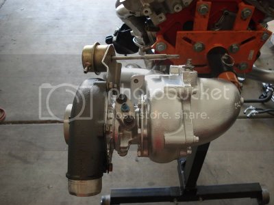

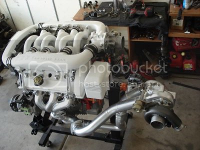

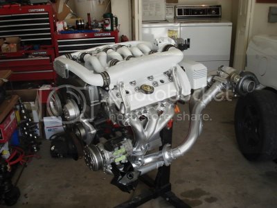

I'm using a Garrett T04b/T3(I believe this is the designation) from a pre-powerstroke 7.3 Ford truck/van. http://www.usdieselparts.com/morein...urbocharger_-_Garrett&CFID=818845&CFTOKEN=780
This turbo works very well for my setup. full boost is around 3K and breaths great all the way to 7K. The lag is minimal and the wastegate is adjustable from about 2-12 psi.
Here's a couple pics.
Enginebuild023
Enginebuild031
Enginebuild018
These turbos are a bit hard to come by but I managed to get mine used off ebay for around $175.
