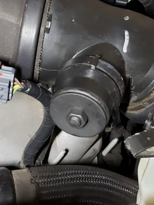

It's just that... A noise maker. Air enters it and makes fake engine noises. If you leave it, you should be fine. Or you can spend some cash on a factory pipe without it, or an aftermarket one without it. Or just remove the part that comes out and plug the hole with a Dorman 02603 Expansion Plug.
Either way, you won't notice a huge change but it does help ensure that it's not leaking air.
I plugged mine and painted it black. Some people have had issues with it blowing off (mainly using other plugs, i.e. a chair leg cap). Just make sure it's seated well and you should be fine. Mine withstands 19 PSI with no issues.

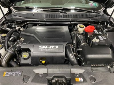

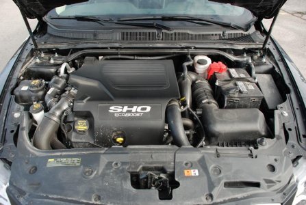

Your 2010 doesn’t have one? Yours must have been modified with an aftermarket pipe. The following are engine bats from
2010 2016 and 2019. All of them have a noisemaker just before the throttle body. It’s the cone shaped plastic piece that points toward the firewall.
Please post a picture of your engine bay so we know what your are working with and where you are coming from.
