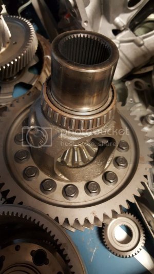

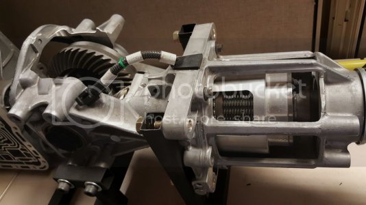

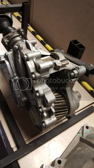

Heat comes from friction and friction is caused by the spinning (or meshing) of the gears. The faster they spin, the more friction they will create. Ultimately, the spinning is exactly what causes wear on gears. To reduce that friction and wear you use oil to reduce the friction and provide cooling. If there's not enough oil to stay cool it will heat up, sludge up, and no longer provide adequate lubrication/cooling. Torque will also play a roll as it's more force on the gear teeth as they mesh. However, I would say that the duty cycle of AWD being engaged is so small that it's insignificant when compared to the wear from simply spinning.
The best analogy I can come up with is if you rub your hands together really fast. Put your hand together lightly and rub them back and forth really fast. They will heat up with almost no pressure. This would be like driving in FWD where there's not a lot of torque through the system but it's spinning. Now push your hands together more and rub them, they will heat up not so much due to speed but due to the force. This would be similar to when AWD is engaged. This is an analogy so it's not perfect, but gets the general idea across. If you rub your hands together lightly (but fast) for 95% of the time and then 5% of the time use more force, which one is going to cause more wear/heat in your hands? They both contribute but due to the duty cycle, I would say most of the wear is due to the spinning.
I would have to pull up my diagram of the PTU to see exactly how it works. But I know a transaxle passes through it. I'm not sure if it's a directly through with only seals or if it's splined into gears in the PTU and then out (thus, all the torque would always be passed through the PTU). I don't know so I won't make that statement, just makes me wonder (I might check tomorow when it's not late).
