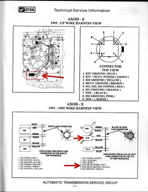

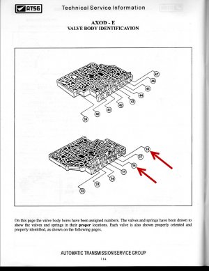

The Lock-Up Solenoid (LUS) - or in the case of all '92+ vehicles, the Modulated LUS (MLUS), is indeed in the valve body - and not only that, all the valving and pistons for the converter clutch are in the valve body. If you want, I can scan and upload the relevant pages from the ATSG guide - but it'll be tomorrow at the earliest.
No hurry man, but yea... I would really appreciate those pages, thanks a lot! :salute:

Whoa.. that's really good info there!
Thanks hawkeye, this will sure help me down the road on fixing this OD / TC issue.
