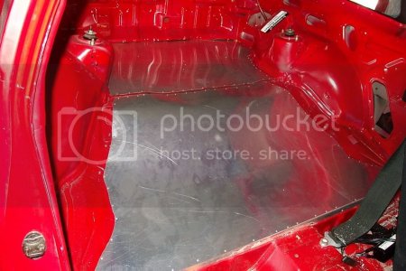

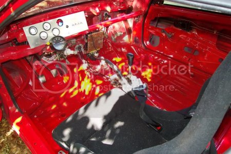

There is at least 1 SHO that I know of that has been modded to the extent of that DSM, Mike Courtney's '89. He doesn't own the car anymore, and I don't know if it even still exists. These are pictures he posted several years ago, ('99 maybe?) when he was selling it. Stripped SHO (I still can't figure out what that crank arm does in the second picture, to the right of the steering column.)
