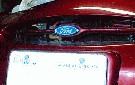

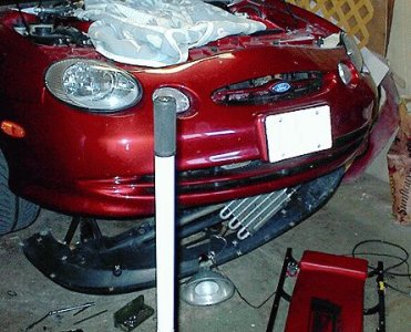

I had a warble once in my front end. Took everything apart and found this....
