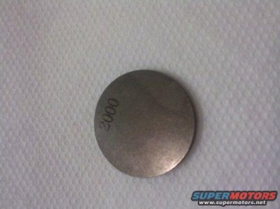

I have down to 2000 I belive on hand.

Got Pics? I dont recall seeing them that low. I went though mine and I go from 2300 to 2800.. Shit I even found a extra pair of Lash caps too! Im glad I read this post today!

I've got a couple 2000's as well. They help when you install new cams and need to find out what the gap is/what size you need.
I can get some pics if you want. I have even up to 3200.
