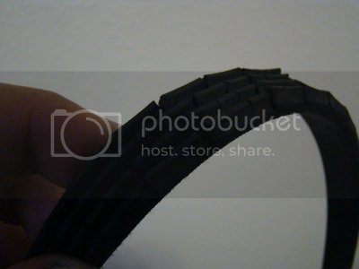

On another note, WTF, how does this thing come out? Is it easier from the bottom? We both have our SHO's torn down to a similar place so I think Joe and I are going to replace both of them.
jthod, you have PM!
Here's my belt jthod btw!
