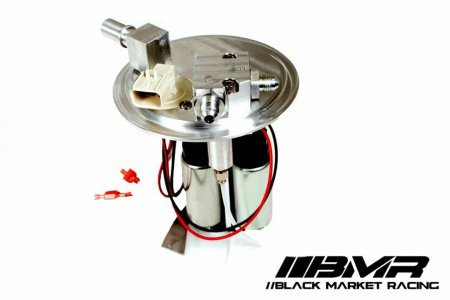

I suggest if you are reaching over 500awhp as a goal to look into an alternative fueling system of some sort. The stock block will hold the boost IF you have the correct fueling. I am running 23psi - 588awhp - 650awtrq with my stock block. I am using an 100% E85 AUX fuel setup (10k miles and its my DD with that tune). Hard piping and an upgraded intercooler will help as well.

@White Beast, sweet looking pump...it really is.
We have already explored that option, and the same goes for "better" injectors. We have looked into larger fuel rails too. The problem with respect to like a larger rail is that if you deplete the supply in the rail you have now starved the engine and are asking for turrible things to occur. Is that worth it for a street car, of course not.
