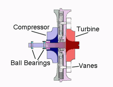

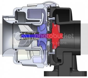

Here is some technology of the turbo, some cutaways and a boost chart:
VATN
66cutaway
Boostchart
