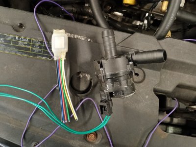

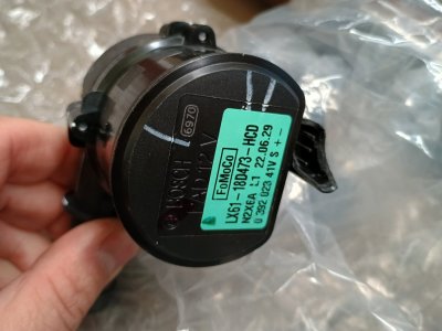

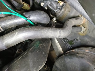

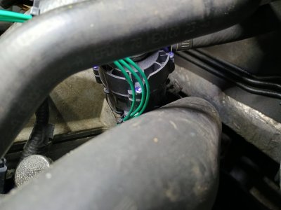

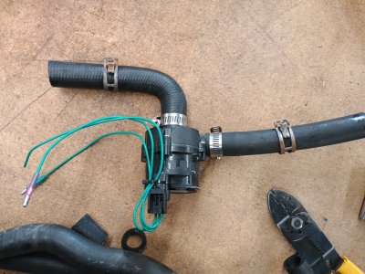

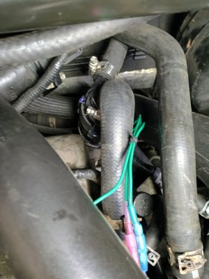

Old thread, agreed not necessary on this platform... I have a 2010 and put one in anyways :shrug: . Granted I had most the needed parts around so the addition cost me under 100$. This is not a turbo timer of old that leaves the car running to allow oil to flow through non liquid cooled turbos. Being this platforms turbos are liquid cooled I added a pump that turns on after the car is shutoff and runs for 3 minutes circulating the coolant. Yes I know this platform uses thermosiphoning to accomplish this, I still found myself always idling after a drive so I installed this setup instead. I used a 3 wire pump because I had one, needed to put in a 1000ohm resistor in the power line to the signal wire to make the pump run at full speed full time. If I replace this pump I will get a 2 wire pump to save me that step. Edit to add part numbers: Bosch 2 wire pump 0392023014 and dorman pigtail connector 645-215. Will also need some 3/4" heater hose and some clamps. The timer I used comes from Timers.shop I went with the 10 amp v9 and a programmer for it. The pictures are with the 3 wire pump I had, The part numbers are for the better option.
