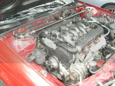

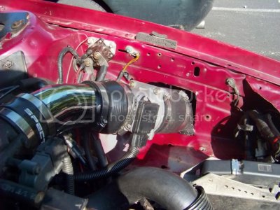

If this isnt all the room you need then you need to sell your sho and buy a carburated v8.

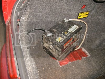

Heres mine. its a complete hack job and needs to be re-done the right way. i shouldnt have even posted it lol.

good thing is at my local track they dont check for test n tune cars.
but i will be re-doing with a sealed case, fuse, and proper wiring.

and you need an outside cutoff switch that will turn engine off.
I've checked a bunch of rules about this, and you're right. My question is why? You don't need a disconnect if the battery is in the engine bay, I don't get why you'd need one if it's in the trunk. Just as easy to pop one as the other...
Anyway, I can tell you that my car won't have a disconnect. I don't care if it's in the rules, my car is street driven and I don't want my battery turned off by every idiot who walks by and wonders what the big switch is for.

You only need the switch at NHRA sanctioned tracks. And then when a Taurus shows up they don't bother th check. At least that has been my experience.

i already have the cutoff just havent installed it yet. i was going to use it when i redo the system. i got the moroso switch for like 30 bucks. Ill probably mount it behind the tail light so when i go to the track ill just take off the tail light for inspection and then put it back on before i race.
