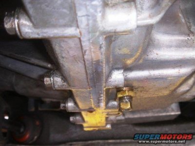

When I installed my drain plug, I had to drill slowly to prevent galling since the casting for the case seems porus. I also installed a plug within a plug so the one in the case remains.
Dsc01565
Bob
Darn it Bob, why didn't I think of that! Oh well, age before beauty.:rofl:

I also wanted to use brass since brass is softer than aluminum. I practiced on my old transmission case a couple times first.
