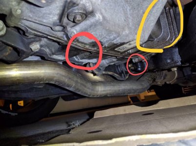

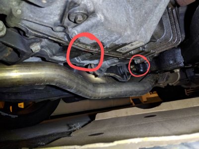

Here is the work they did, and places it's dripping from. I'm going to guess it didn't seal back up properly or someone didn't do there job correctly9be807c6482883a7232065062e34d6142250e31213bdd7ae232b00bf809b6292

Look how wet it is by the cv shaft. (Yellow)
I’m guessing it’s leaking here and running down to the low point and pooling.
8b2a24e701bfd3d4766238bab0659281
That's a good guess, ford is going to take a look at it within the next couple of days. It looks like more than just the CV shaft is wet if you look more deeply in the pic....not sure the black case behind the CV shaft, but it looks like it's wet tooC46c696791132599e971b308236db7f3
