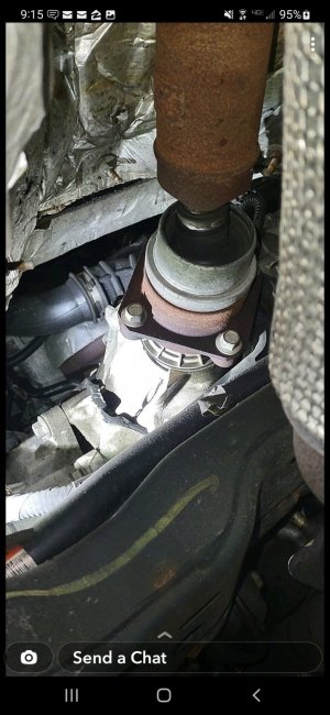

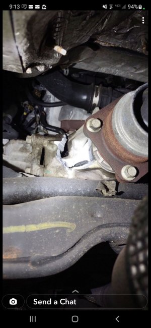

73,000 miles. I bought the cat a year and a half ago and it originally had 56,000 when I bought it and I’m the second owner. It was due for service in early August. I was going about 25 miles and hour through a small town when I heard this clunking, then grinding, then saw smoke and was like yep it’s done. Luckily I was near work and got it off the road. I guess there was no fluid in the transfer case. I guess it either leaked out or it must have evaporated. I never had a puddle or a sensor to tell me it was low. I was told maybe the exhaust is near it and the heat from the dual exhaust caused it to evaporate…that one in not believing. What I think is the dealership I bought it from never serviced it and the one thing I didn’t do is check the level cause I’m not sure you can in these but I’d think the dealership I bought it from would but I can’t be sure.

Seems all the fluid leaked out one night and bam, it overheated and was game over, no warning, or check engine light or nothing. 1700 dollars later and she’s back in service!!

These are 'lifetime' fluid sealed units with exceptions for PP and police. I think there is evidence that the high temps outside along with the high friction and temps inside cause the fluid to decompose and have the unit fail. You can look inside other failed units that did not break the case open like yours did and see the fluid cooked and gooey on the inside. Insulating/shielding the unit from the exhaust and cat isn't the dumbest thing I ever heard.

I heard that was a main cause the heat. Mine was bone dry and no fluid. I had a puddle in my driveway the next day after I took it in and they said it had to of leaked out cause I asked them if any was in it. Any recommendations on what to use to shield it??
