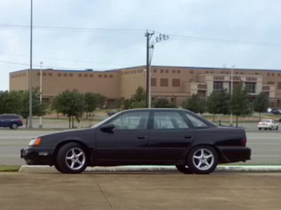

BILLGSHO
(That building in the background is a high school)

How wide are those wheels?
Don't know - I'll have them measured when the work is being done. They are Borbet wheels. That reminds me - anyone know how to prevent people from stealing the Borbet center cap (they go for $20+ on eBay)? Is it O.K. to glue them in?

No need to measure, the wheels will have the diameter and width somewhere on the inside.

Installed the tires. Didn't have a chance to test them out, so let's see how tomorrow's commute goes.
The TPMS is really cool. Shows the tire pressure all around, the temperature of the tires, and also the car battery voltage!
On the inside of the wheels it's stamped 7½J x 16 H2.

Timbo, nice looking '89 back at cha! If I had gone with a white SHO I would have wanted it to look like yours.

Those are wider than I expected. I'm extremely curious what the tires look like mounted.
